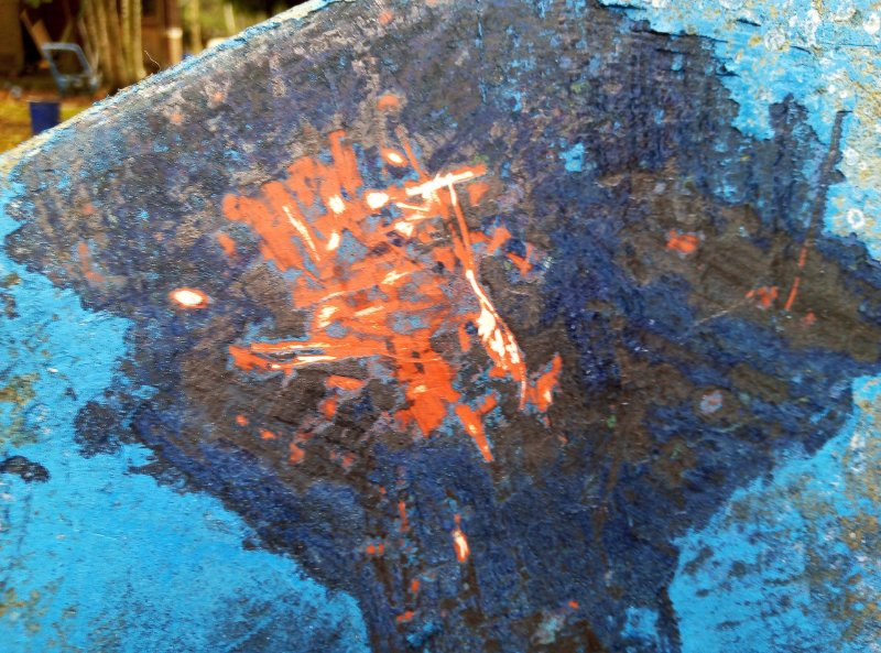

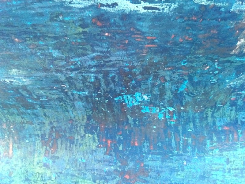

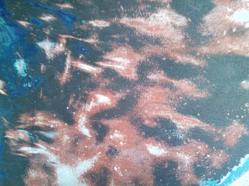

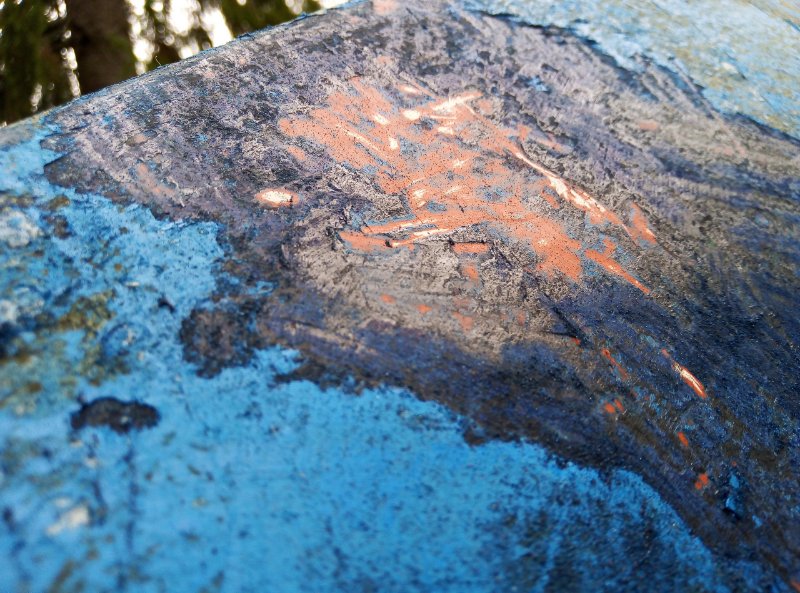

Oh! I brought home a rudder for the experiments
It have 6 layers of paint:
light-blue layer with soft mechanical consistence;
deep-blue layer - soft;
black layer - hard,
thin light-blue layer again, with undefined mechanical cosistence;
polygrund.
Maybe, it will be enough just to scrap off only 2 upper blue layers? Have you any ideas about the type of a hard black paint?

You will be laugh, but I find the best tool to fast and safe scraping upper layer... This is the most ordinary axe, used like a scraper.
5 minutes, and the rudder is ready to grinding. I found a couple of blisters under the paints, but I think, what this is not critical. Moreover - this is rudder, which always keeping wet, with water inside! I drilled the holes, recommended here.
In the end I think to leave the black paint as is, because it is very hard to grind off, and it staying very well on a grund. Also, I suggested to use an industrial vinyl-epoxy antifouling. But I still feeling doubts about barrier layer on a probable-wet laminate.

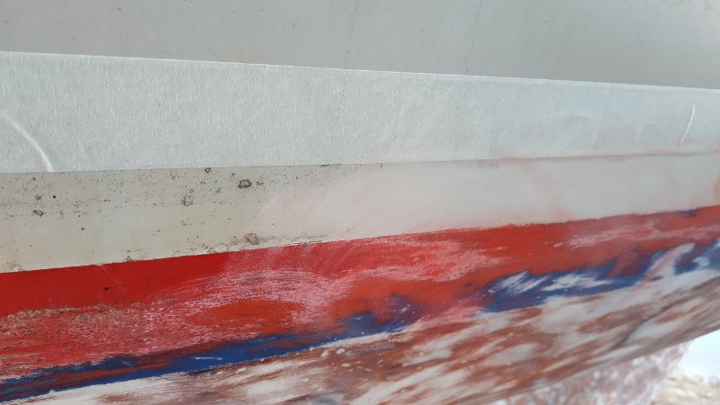

I'm started. Today I was scraped all the left board and I wasnt found there any osmosis or blisting. It's great!
I think, that "black paint" was exactly that "barrier layer". It have a perfect adhesion to the gelcoat, and it very hard to scrap. In short, I mean, that is not nessesary to totally remove it - just do matte, then cover with the epoxy.

I think you are doing well! If the black paint sits that hard, then leave it.
From the pictures I think you have made the right decision to renew the boat underwater painting.

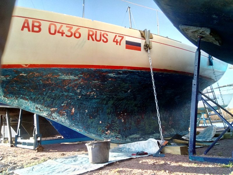

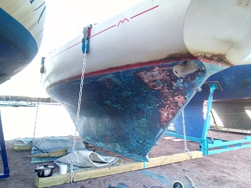

Spring is coming, and I started to grind. In 8 hours total, I grinded off a half of boat. Later I'll grind a right half, and will waiting about a month.
The technology of covering I see as follows:
When the constant positive temperatures will established, I will wait for a few Sunny days. Then I'll grounding IF's bottom with a pure epoxy. After about 12hrs, I'll overcoat first layer with mixture of epoxy and aerosil (tixotropic additve, which helpes to make more thick layer). Then, after another 12hrs I'll cover this with the most common and xx ground - for further layer of antifouling.

Re: To grind or not to grind?
Well done!
The forum software should scale down your images automativally if they are too big. Doesn't that work?

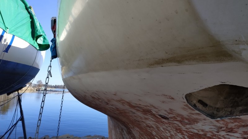

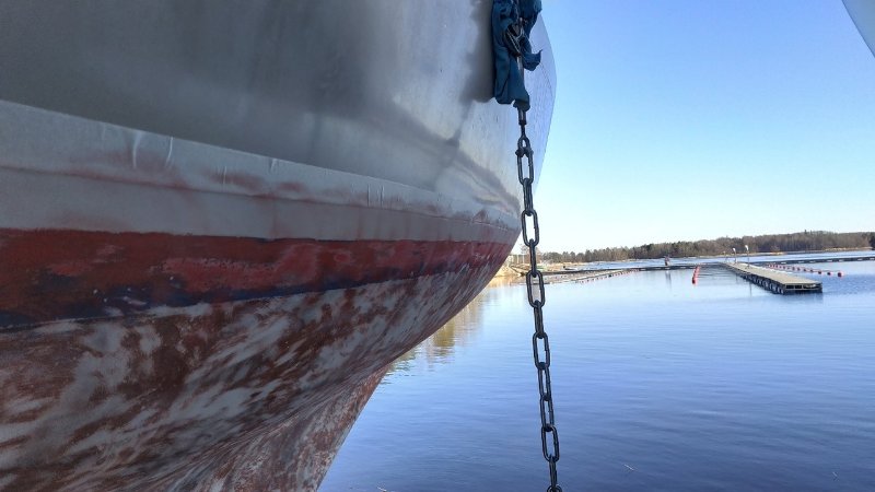

So, I grinded hull quickly for a few days and leaved to stay it naked during April. A dry and sunny weather is staying, and this qute perfect! Now is time to a final preparing for a painting
Also, I want to lift a waterline for a few centimeters up.
After a couple weeks I'll buy about 20kg of epoxy resin and some primer in the sales office of chemical factory, and then could to paint the bottom.
That looks good! I think it is clean enough for the epoxy painting. Those last old Polygrund primer rests wont have to be removed.
Follow the instructions for the epoxi resin. Wait for some days with good weather, so that you can paint the layers with the proposed settling time between. If you wait too long after one layer, you probably will have to sand before putting the next one on.
