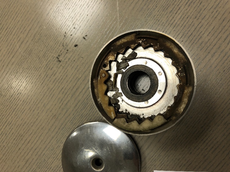

I am overhauling IF 2670 - C. Mary

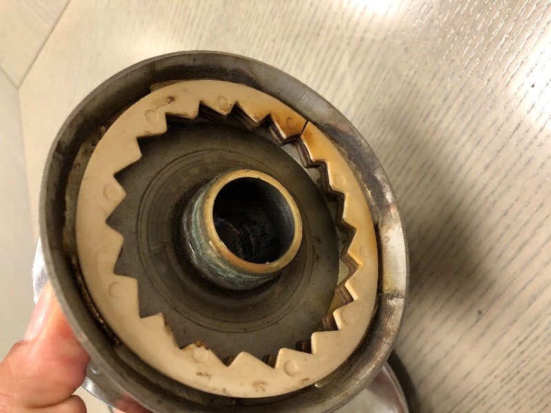

I disassembled the Anderson winches. Luckly NL distributor has the small parts kit but they do not have the broken plastic teeth. What is the function of it?

If I remember right my two original winches also have those plastic inserts and my two newer ones came without them.
I don't know for sure what purpose they have. One possibility is that the plastic insert is just for keeping the mechanism a bit quieter. Now when I think about it two of my winches are actually louder than the other two.
I think you can just remove those plastic inserts. The winch will probably work without them, Now that the inserts are broken, you can't make it worse, anyhow.

I have the same on my boat, two older with plastic inserts and two newer without.
The winches without plasic inserts have another, more metallic sound than the two other.
I think you can follow Johan´s advise and just remove the plastic.

Thanks for the replies, I removed the broken ones, actually NL distributor checked with Andersen factory and they informed me that they can supply the plastic teeth but winches worked well and I did not notice any additional friction or sound...
